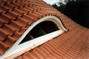

    in january i will be building a roof that will have two eybrows ,i am lacking any detail from architects etc any hints ,tips ,sketches,photos would be a great help.
    CHEERS.................chubbs

    Default Re: eybrow roof
    Go here http://www.jkburks.net/jlc/framing/twr-frame.html
    You will see most everything you need to know about doing an eyebrow dormer. At least from the outside. The front arch frame is made from layered plywood, the roof rafters lay onto the roof above, and layered thin plywood is used to sheath. Look at the pics of the sheathed dormer, and not the orientation of the ply. Bend it shortways and it is easier than bending it longways. Think handrolled cigarettes when bending 4x8 sheets to a roof curve.
    I would take a different approach I like to have a series of curved and diminishing rafters going with the curved roof. The valley boards will look like a Napoleon hat when done. The sheathing is then done down the roof not across and can be done easily without the twist and bend that is required to cross a multi curved surface. If you want to cross the roof with the sheathing find a good boat-building book and learn how to spile a plank easy but lots of work. Here is a model I used for a class on eyebrow dormers . The drawing technique is simple but requires several drawings to get all the required angles and bevels. I have used large lvls and cut out the shapes. I have also done this with a curved ceiling underneathe which will reqquire a curved valley tricky. I have a hand held bandsaw to do this so it is fairly easy but will take some time. The valley sleepers are made with 2/12 or any dimenisonal lumber that works . The two curves must be fair to each other which means that they must have the same relationship to each other. If you e mail me I will send you a drawing on how to do this
    Attached Images Attached Images
    ollee: That's a really nifty model of an eyebrow. I have never had the chance to build the real thing, but here's a Purlin/Square Tail Fascia meets Main Roof Calculator which may help with the miter/bevel angles. There's a link from the calculator to some sketches of Purlins following Ellipse intercept Main Roof which show how to find the slopes along an ellipse to be entered in the calculator. The arch of the eyebrow doesn't have to be elliptic, it may be any curve.
    thanks for the tips folks,i have been a joiner for forty years but i have never built an eye brow roof ,they will not be dormers as such ..the eyebrows will be supported by green oak window frames that go from ground level up to the eaves .the external walls will be built from random york stone and the roof will be Westmoreland slate with diminishing courses.by the way i am from the cheshire area of england
    Hey chubbs Find a book written by Manfred Euchner called Fledermausgaube. It is the best book written on eyebrows. It is written in german but if you follow the drawing system there is no need to read the text He has several ways to layout the curves and how to deminish the dormers. I spent a week following the drawings and then just had at it. You must make a one to one drawing of dormer and the main roof in section in order to get the sleeper bevels and the curved valley exact . When you draw and layout the first one it seems like magic. You must be precise however and I color code the lines such as red top and black bottom. I will scan a drawing of how to relate the curves and how to develope the valley sleeper curves and bevels. As for the book check out abebooks.com

    Bob Dylan and ollee, thanks again for the eyebrow dormer photo essay and the picture of the scale model. Very informative.
    I see that I'm going to have to modify my definition of the angle of the "Main Roof", or "Main Roof Pitch", to an angle of intercept between the dormer ridge and roof slope as viewed in section.
    chubbs, what's a joiner? Joinery as in timber framing?
